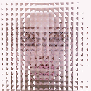

Amplitude of cell noise shader keyframed
Cell noise is a very versatile shader that can be used to reproduce a wide variety of shading effects. In this short and simple tutorial, we will show possible uses for it to produce an abstract 'collage' style graphic effect. We will connect the cell noise shader to the displacement attribute of a transparent object in front of the camera to distort the subject matter behind it (in this case a head). We will use the various attributes of the cell noise shader to reproduce some of the example images below (all of which can be animated).

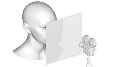

- Start off by creating a plane (feel free to use other shapes) and position it between the camera and the subject (in this case a head model).
- Create a skydome light. Ensure that the default camera visibility of the skydome light is 1 so that there is something to refract other than black.

- Create a cell_noise shader and use it to displace the plane. The overall effect depends on how much displacement you use. Start off with small values and work your way up.

Randomness
Changing the randomness value can have a big effect on the result.
| 0 | 0.5 | 1 |
