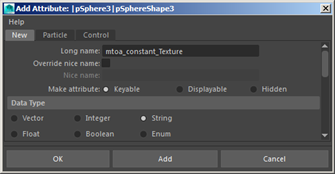

  • Create a sphere and add an extra attribute to the shape node (not the transform node). Use the down key (pickWalkDown) to select the shape node.
  • Add the Long name - 'mtoa_constant_Texture' ('Texture' is the prefix that we will use for the User Data String, but you can call it what you want (do not use 'name', it will not work). Set the 'Data Type' to 'String'.

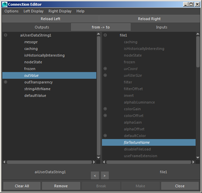

  • Open the connection editor for both of them. Connect the outValue attribute of the User Data String node to the fileTextureName attribute of the 'file texture' node:

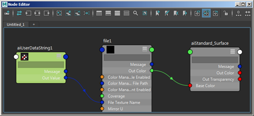

The shader network should look like this:
Ai User Data String connected to file texture node

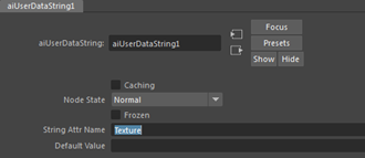

  • Select the Ai User Data String node and type in the prefix that was added to the attribute for the sphere (in this case 'Texture').
