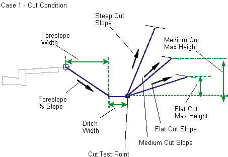

Flat Cut Slope |
First, flattest, catch slope to attempt. (x : 1) |
Numeric, positive |
6 ( : 1) |
Flat Cut Max Height |
Maximum allowable height of the closing link using the Flat Cut Slope |
Numeric |
1.5 m 5 ft |
Medium Cut Slope |
Cut slope to attempt if the Flat Cut Slope link exceeds the Flat Cut Max Height |
Numeric, positive |
4 ( : 1) |
Medium Cut Max Height |
Maximum allowable height of the closing link using the Medium Cut Slope |
Numeric |
3 m 10 ft |
Steep Cut Slope |
Cut slope to use if the Medium Cut Slope link exceeds the Medium Cut Max Height |
Numeric, positive |
2 ( : 1) |
Foreslope Width |
For cut sections, the width of the front-of-ditch link |
Numeric |
3.6 m 12 ft |
Foreslope Slope |
Slope of the front-of-ditch link (x : 1). This link is always inserted downwards. |
Numeric, positive |
4 ( : 1) |
Ditch Width |
Width of the bottom of ditch. Use zero for a V-ditch. |
Numeric, positive |
1 m 3 ft |

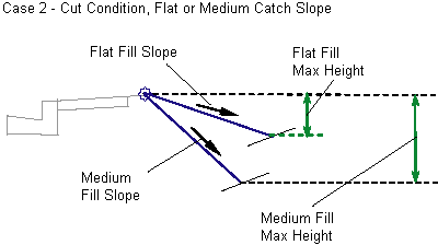

Flat Fill Slope |
Numeric, positive |
6 ( : 1) |
Flat Fill Max Height |
Maximum allowable height of the closing link using the Flat Fill Slope |
Numeric |
1.5 m 5 ft |
Medium Fill Slope |
Fill slope to attempt if the Flat Fill Slope link exceeds the Flat Fill Max Height |
Numeric, positive |
4 ( : 1) |
Medium Fill Max Height |
Maximum allowable height of the closing link using the Medium Fill Slope |
Numeric |
3 m 10 ft |
Steep Fill Slope |
Fill slope to use if the Medium Fill Slope link exceeds the Medium Fill Max Height |
Numeric, positive |
2 ( : 1) |

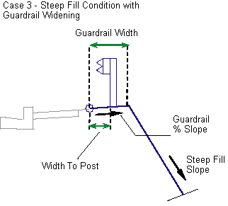

Guardrail Width |
Width of the guardrail widening link for fill slopes using Steep Fill Slope. Use zero for no guardrail widening. |
Numeric, positive |
0.6 m 2 ft |
Guardrail %Slope |
% slope of the guardrail widening link |
Numeric |
-2 (%) |
Include Guardrail Omit Guardrail |
Include to insert the guardrail structure when guardrail widening occurs. Omit does not insert the guardrail structure. |
Include / Omit |
Omit |

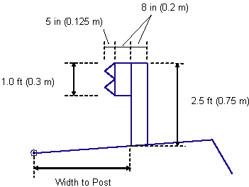

Width to Post |
When the guardrail is included, the width from the attachment point to the inside edge of the guardrail post. |
Numeric |
0.3 m 1 ft |

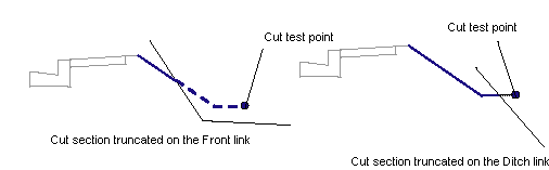

- The location of the Cut Test Point (see diagram) is calculated using the Foreslope Width, Foreslope Slope, and Ditch Width parameters.
- If any portion of the foreslope slope or ditch bottom is in cut, the section is computed as a cut section as follows:
- If the Cut Test Point is above the target surface, the Foreslope link or ditch bottom is truncated at the point where it intersects the surface going from cut to fill, otherwise:
- If Include Daylight Link is set to omit, no daylight link is calculated.
- The intercept to the target surface is calculated using the Flat Cut Slope value.
- If the height of the flat cut slope exceeds the Flat Cut Max Height, the intercept to the target surface is re-calculated using the Medium Cut Slope value.
- If the height of the medium cut slope exceeds the Medium Cut Max Height, the intercept to the target surface is re-calculated using the Steep Cut Slope value.
- If no portion of the foreslope link or ditch bottom is below the target surface, the section is computed as a Fill section as follows:
- The intercept to the target surface is calculated using the Flat Fill Slope value.
- If the height of the flat fill slope exceeds the Flat Fill Max Height, the intercept to the target surface is re-calculated using the Medium Fill Slope value.
- If the height of the medium fill slope exceeds the Medium Fill Max Height, the guardrail widening link is added to the assembly using the Guardrail Width and Guardrail %Slope parameters (unless the Guardrail Width is zero). The intercept to the target surface is re-calculated from the outside edge of the guardrail widening link using the Steep Fill Slope value.
- If Include Daylight Link is True, the flat, medium, or steep fill slope link is added to the assembly.
A guardrail structure may be applied to fill sections that meet the criteria for using the steep fill slope. If this criteria is met, the Guardrail Width is not zero, and Include Guardrail is set to true, then a guardrail structure is drawn at the station. The dimensions of the guardrail structure are fixed as shown in the diagram below.

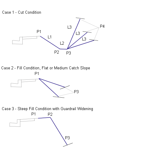

Point, Link, and Shape Codes
The following table lists the point, link, and shape codes for this subassembly that have codes assigned to them. Point, link, or shape codes for this subassembly that do not have codes assigned are not included in this table.
Point, Link, or Shape |
Code |
Description |
P1 |
Hinge Hinge_Fill |
Hinge point for the normal fill condition |
P2 |
Hinge Hinge_Fill |
Hinge point for the fill condition with guardrail widening |
P2 |
Ditch_In |
Inside edge of the bottom of the ditch (cut condition only) |
P3 |
Ditch_Out Hinge Hinge_Cut |
Outside edge of the bottom of the ditch (cut condition only) |
P3 |
Daylight Daylight_Fill |
Fill slope stake point (fill condition only) |
P4 |
Daylight Daylight_Cut |
Cut slope stake point (cut condition only) |
All Links |
Top Datum |
All links added by this subassembly, except for the guardrail structure links. |
Guardrail points |
None |
No codes are assigned to the points on the guardrail structure, if included. |
Guardrail links |
Guardrail |
All links comprising the guardrail structure, if included. |
L3 |
Top Datum Daylight Daylight_Cut |
Daylight link for cut section |
Fill Daylight Link |
Top Datum Daylight Daylight_Fill |
Daylight link for fill section |
