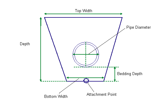

This subassembly creates a stone-filled drain structure with a circular pipe inside.
The attachment point for this subassembly can be at the bottom center, the top center, or the top corner of the drain structure.
Input Parameters
Note: All dimensions are in meters or feet unless otherwise noted. All slopes are in run-over-rise form (for example, 4 : 1), unless indicated as a percent slope with a “%” sign.
| Parameter | Description | Type | Default |
| Side |
Specifes to insert the subassembly either on the right or the left side of the attachment point. |
Left / Right | Right |
| Attachment Point | Specifies location of subassembly attachment point. | String; (a) Top center; (b) Bottom center, (c) Top corner | Top corner |
| Bottom Width | Bottom Width of the trench | Numeric, Positive |
1.0 ft 0.3 m |
| Top Width | Top width of the trench | Numeric, Positive |
1.5 ft 0.5 m |
| Depth | Total depth of the trench | Numeric, Positive |
2.0 ft 0.6 m |
| Bedding Depth | Depth of the pipe bedding over trench bottom | Numeric, Positive |
0.6 ft 0.2 m |
| Pipe Diameter | Drain pipe diameter | Numeric, Positive |
0.6 ft 0.2 ft |
| Pipe Thickness | Thickness of the pipe material (optional) | Numeric, Positive |
0.0 ft 0.0 m |
Target Parameters
This section lists the parameters in this subassembly that can be mapped to one or more target objects, such as a surface, alignment, or profile object in a drawing. For more information, see To Specify Corridor Targets.
| Parameter | Description | Status |
| Depth | Depth of the trench can be optionally be overridden from a profile elevation. If the attachment point is on the top of the trench, then this profile is assigned for the trench bottom and vice-versa. The following object types can be used as targets for specifying this elevation: profiles, 3D polylines, feature lines, or survey figures. | Optional |
Output Parameters
Behavior
The subassembly builds the shape for a simple drain structure as shown in the above illustration.
