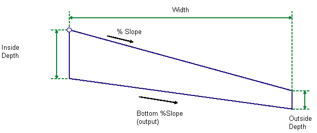

This subassembly inserts a trapezoidal shape with flexible parameters and codes.
This shape can be used as a lane or a shoulder using superelevation parameters for the slope. The width and outside edge elevation can be calculated based on an optional alignment and profile. If multiple shapes are stacked, the bottom slope can be used as the top slope of subsequent shapes. If shapes are butted together, the outside depth can be used as the inside depth of the next subassembly. The point, link, and shape codes are left undefined so the shape can be used to represent different materials in various scenarios.

Behavior
The finish grade of the shape is inserted for the given Width and % Slope outward from the attachment point. The bottom link slope is calculated based on the inside and outside depth of the shape. The point, link, and shape codes are set in the input parameters using the user-defined strings.

Point, Link, and Shape Codes
The following table lists the point, link, and shape codes for this subassembly that have codes assigned to them. Point, link, or shape codes for this subassembly that do not have codes assigned are not included in this table.
Type |
Code |
Description |
P1 |
Inside Top Code |
User-defined point code |
P2 |
Outside Top Code |
P3 |
Inside Bottom Code |
P4 |
Outside Bottom Code |
L1 |
Top Link Code |
User-defined link code |
L4 |
Bottom Link Code |
S1 |
Shape Code |
User-defined shape code |
Coding Diagram
