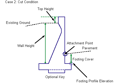

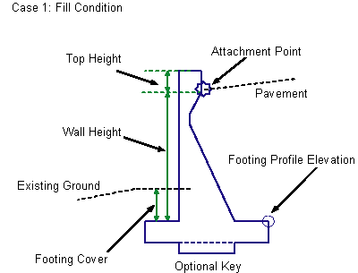

Behavior
This subassembly can be inserted on either the left or the right sides. The attachment point is different for the fill or cut condition. In fill, the attachment point is assumed to be where the finish grade intersects the inside face of the wall, at a distance below the top of the wall equal to the Top Height parameter. In a cut condition, the attachment point is assumed to be where the finish grade intersects the inside face, above the top-of-footing at a distance equal to the Footing Cover parameter. The wall height is determined from the Wall Height or Profile input.
In a fill condition, the sloping wall face is toward the center of the roadway. In a cut condition, the sloping wall face is away from the roadway, toward the earth being retained. If the Key option is set to No, then the base of the footing is a single horizontal link. If the Key option is used, links to define the optional key are created.

Coding Diagram
Fill Condition
Cut Condition
