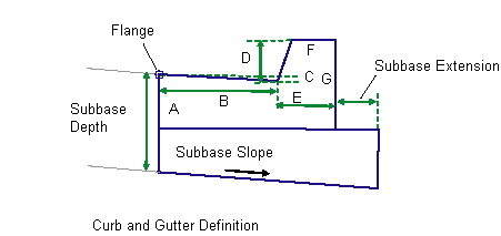

Dimension A (mm/in) |
Depth of the gutter at the flange point. |
Numeric, positive, non-zero |
175 mm 7 in |
Dimension B (mm/in) |
Width from the flange point to the gutter flowline. |
400 mm 16 in |
Dimension C (mm/in) |
Depth from the flange point to the gutter flowline. |
25 mm 1 in |
Dimension D (mm/in) |
Height of curb from the gutter flowline to the top-of-curb. |
150 mm 6 in |
Dimension E (mm/in) |
Width from the gutter flowline to the back-of-curb. |
200 mm 8 in |
Dimension F (mm/in) |
Width of the top-of-curb. |
150 mm 6 in |
Dimension G (mm/in) |
Height of the back-of-curb. |
325 mm 13 in |

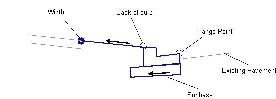

This subassembly is used to place a new curb and gutter parametrically, and can optionally tie (with a sod strip) into either the inside edge of the existing sidewalk, or to a new sidewalk created with another subasembly. The horizontal placement of the curb and gutter is determined from the previously know flange point location. Highside of the sod strip can be located either by a fixed offset or any other marked point, such as inside edge of sidewalk. Alternatively this point can come from the target parameter of an aligment and profile. Newly designed flange point, optionally marked so that it can be used as input later for replacement lane subassemblies.

All other curb and gutter links are inserted based on the Input Parameter dimensions Dimension A - Dimension F. All dimensions must be positive, non-zero values. If a non-zero subbase depth is given, the subbase layer is inserted to the back of curb, and continues for the Subbase Extension width. The subbase layer closes to the bottom-back-of-curb as shown in the diagram.
Layout Mode Operation
In layout mode the subassembly is set based on the attachment point and the default flange point offset from baseline. Width of the sod strip is computed by subtracting the curb and gutter total width from "flange point to attachment point" distance. Use 2% slope to calculate the low side of sod strip (or back of curb point), from which the rest of curb and gutter is drawn using the input parameters given.
