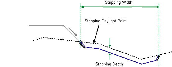

Behavior
This subassembly inserts parallel links defining the bottom of the stripping layer below a specified surface. The stripping starts at the insertion point just below the specified surface. A foreslope link is placed from the insertion point to the side specified in the input parameters. This link is drawn until the elevation difference between its lowest point and the existing ground is equal to the “stripping depth”.
Similarly, a backslope link is drawn from the topsoil surface at an offest specified by the “stripping width” from the insertion point. Again the depth of this link is such that the elevation difference at the bottom of the link, with respect to the topsoil surface, is equal to the stripping depth.
Now a series of links parallal to the specified topsoil surface are introduced connecting above two new links to define the stripping layer.
To insert vertical links at the insertion point, and or at the other end of the stripping, specify foreslope and or backslope values to zero.
Layout Mode Operation
In layout mode, foreslope and backslope links are added using the input parameters. Connecting the bottom of these two links, a horizontal line is added to represent the stripping layer.

Coding Diagram
