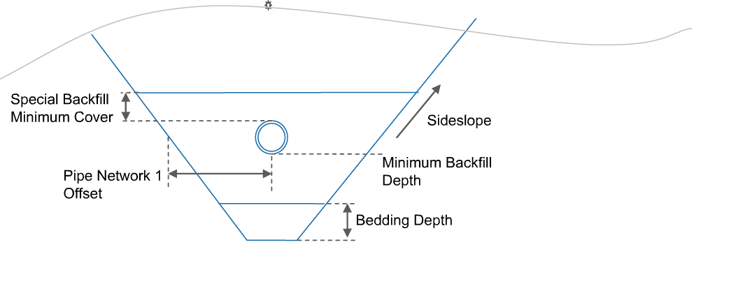

Behavior
In both cases, the subassembly will determine the bottom of the trench depth and the trench width based on the location of a pipe (or pipes) in a specified pipe network. The Special Backfill Minimum Cover is determined by measuring the distance from the centerline of the highest pipe found at the sampled section. The Special Backfill Minimum Depth is determined by measuring the distance from the bottom outer diameter of the lowest pipe found at the sampled station.
Case 1: Single Pipe Network Selected
If only Pipe Network 1 is selected, the subassembly will search 3 feet (1m) from the controlling baseline to the left and right to find the pipe center line at the sampled station. Apply the Pipe Network 1 offset value to both sides to determine the trench width, or the minimum width, whichever is larger. The offset value is applied from the outer wall of the pipe as shown in the illustration. The bottom of the trench is determined by the outer pipe diameter, plus the Special Backfill Minimum Depth, plus the Bedding Depth.

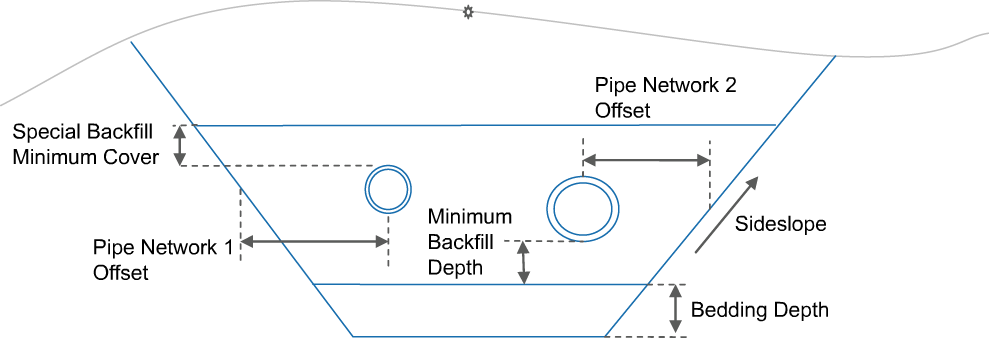

Case2: Two Pipe Networks Selected
When two pipe networks are selected, Pipe Network 1 will be assumed to be on the left side of the baseline. Pipe network 2 will be assumed to be on the right side of the alignment. The material depth of the Special Backfill Minimum Depth is determined by the higher of the two pipe outer diameters, plus the Special Backfill Minimum Cover depth. The bottom of the trench depth is determined by the lower of the two pipe outer diameters, plus the Special Backfill Minimum Depth, plus the Bedding Depth.
Layout Mode Operation
In layout mode, this subassembly draws a trench as shown in the previous illustrations.
