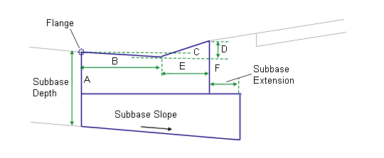

Dimension A |
Depth of the gutter at the flange point |
Numeric, positive, non-zero |
175 mm 7 in |
Dimension B |
Width from the gutter flange point to the gutter flowline |
375 mm 15 in |
Dimension C |
Depth from the gutter flange point to the gutter flowline |
25 mm 1 in |
Dimension D |
Height from the gutter flowline to the top-of-curb |
75 mm 3 in |
Dimension E |
Width from the gutter flowline to the top-of-curb |
250 mm 9 in |
Dimension F |
Height of the back-of-curb |
250 mm 9 in |
Behavior
The curb and gutter links are inserted based on the Input Parameter dimensions Dimension A – Dimension F. All dimensions must be positive, non-zero values. If a non-zero subbase depth is given, the subbase layer is inserted to the back of curb, and continues for the Subbase Extension width. The subbase layer closes to the bottom-back-of-curb, as shown in the diagram.
