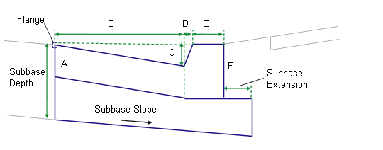

This subassembly inserts links for a slope-bottomed valley curb and gutter with subbase.
The bottom surface of the curve flattens to a horizontal link at the gutter flowline. User-defined input parameters control the dimensions of the shape.

Dimension A |
Depth of the gutter at the flange point |
Numeric, positive, non-zero |
150 mm 6 in |
Dimension B |
Width from the gutter flange point to the gutter flowline |
600 mm 24 in |
Dimension C |
Depth from the gutter flange point to the gutter flowline, and from the gutter flowline to the top-of-curb |
50 mm 2 in |
Dimension D |
Width from the gutter flowline to the top-of-curb |
40 mm 1.5 in |
Dimension E |
Width from the top-of-curb to back-of-curb |
150 mm 6 in |
Dimension F |
Height of the back-of-curb |
300 mm 12 in |

The curb and gutter links are inserted based on the Input Parameter values for Dimension A – Dimension F. All dimensions must be positive, non-zero values. If a non-zero subbase depth is given, the subbase layer is inserted to the back of curb, and continues for the Subbase Extension width. The subbase layer closes to the bottom-back-of-curb, as shown in the diagram.
The subassembly builds the shape for a simple curb and gutter, with the attachment point either at (a) inside edge of the gutter (or lip), or (b) the back of the curb. The face of the curb is given a small, constant width to make it non-vertical.
