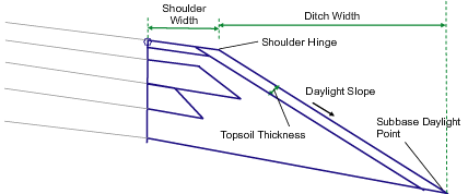

The finish grade of the shoulder is inserted for the given Shoulder Width and Default Shoulder Slope outward from the attachment point. The subbase link is inserted from the attachment point starting at the Subbase Depth below the finish grade.
The shoulder daylight link can be inserted with either a fixed slope (Hold Daylight Slope = True), or a fixed width (Hold Daylight Slope = False). If a fixed slope is used, the daylight link is extended from the outside edge of the shoulder until it intersects the subbase link. Otherwise, the subbase layer is extended for the Daylight Width beyond the outside edge of the shoulder, and the daylight link is connected to the end of the subbase.
If topsoil material is set to “a positive” value then a new material layer is introduced to the specified thickness right below the daylight link. The thickness is measured perpendicular to the shoulder daylight ink. This layer extends from the top layer of the shoulder to the subgrade daylight link at the bottom. Due to this new layer provision, width of the shoulder top layer will be adjusted as shown in the following illustration.

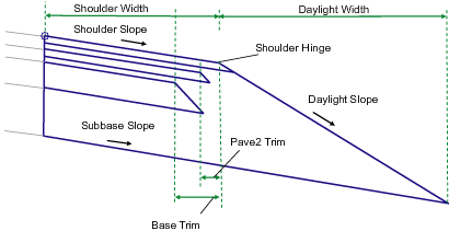

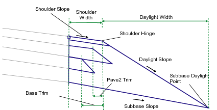

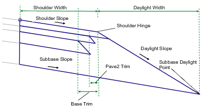

The Pave1, Pave2, and Base surface links are inserted parallel to the finish grade at the given depths until they intersect with the shoulder daylight link.
If the above trim values are set for a positive value then top of respective material will be shortened by that value and the bottom link will be derived with material side slope equal to the daylight slope.
Further, if the “gap between Pave1/Pave2 and/or Pave2/Base” is set to a positive value – then those lavers will be separated by that gap as shown in the illustration below.
If the gaps between Pave1/Pave2 and Pave2/Base are set to ZERO then the subassembly will be drawn as shown below.
If the sub-layers are set with zero trim values, then this subassembly will be similar to the ShoulderExtendAll subassembly with optional topsoil lining.
