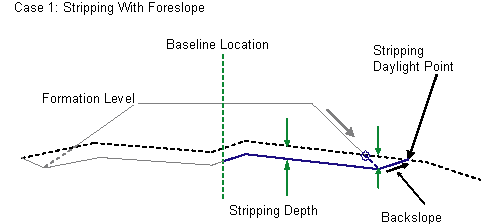

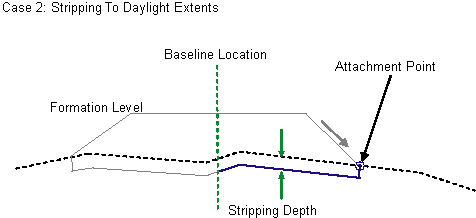

Behavior
This subassembly inserts parallel links defining the bottom of the stripping layer below a specified surface. If the option to extend stripping to the existing ground with a backslope is set to No, then stripping starts at the attachment point directly on the specified surface, with a vertical link with depth value specified in the input parameters. From the bottom of this vertical link, a series of links parallel to the specified surface are introduced inwards, until the baseline location of the assembly. If the option to extend stripping to the existing ground is set to Yes, then at the attachment point, a link is introduced with the specified foreslope, until the elevation difference between the bottom of this new link and the specified existing ground is equal to the “stripping depth”. From this point, a series of links parallel to the specified surface are introduced inwards, until the baseline location of the assembly. Additionally, another link outwardly is added to daylight to existing ground.

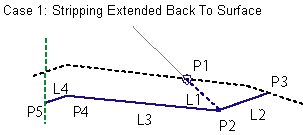

| Point/Link | Codes | Description |
| P3 | Daylight_Strip (Only for Case 1) | Daylight point of stripping backslope link |
| L1 | Foreslope_Stripping (Only for case 1) | Stripping foreslope link defining backfill |
| L2, L3, L4… Ln | Stripping | Stripping links |
