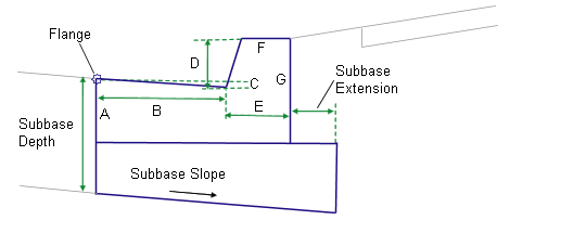

Dimension A (mm/in) |
Depth of the gutter at the flange point |
Numeric, positive, non-zero |
175 mm 7 in |
Dimension B (mm/in) |
Width from the flange point to the gutter flowline |
400 mm 16 in |
Dimension C (mm/in) |
Depth from the flange point to the gutter flowline |
25 mm 1 in |
Dimension D (mm/in) |
Height of curb from the gutter flowline to the top-of-curb |
150 mm 6 in |
Dimension E (mm/in) |
Width from the gutter flowline to the back-of-curb |
200 mm 8 in |
Dimension F (mm/in) |
Width of the top-of-curb |
150 mm 6 in |
Dimension G (mm/in) |
Height of the back-of-curb |
325 mm 13 in |
Behavior
The curb and gutter links are inserted based on the Input Parameter dimensions Dimension A – Dimension F. All dimensions must be positive, non-zero values. If a non-zero subbase depth is given, the subbase layer is inserted to the back of curb, and continues for the Subbase Extension width. The subbase layer closes to the bottom-back-of-curb, as shown in the diagram.
The subassembly builds the shape for a simple curb and gutter, with the attachment point either at (a) inside edge of the gutter (or lip), or (b) the back of the curb. The face of the curb is given a small, constant width to make it non-vertical.
