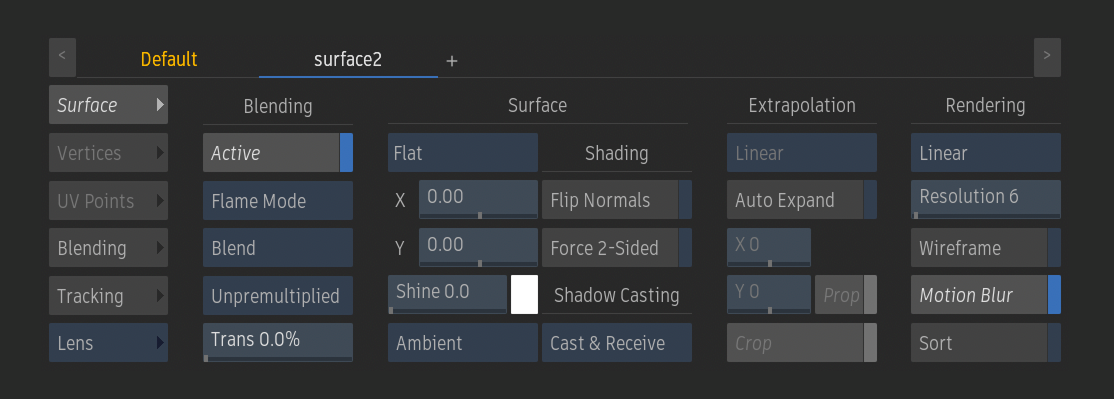

After you set the parent-to-child relationships between lights and surfaces, you can set specific surface lighting properties. You control a surface's lighting and adjust the surface's specular highlight in the Surface menu. To access the Surface menu, double-click the selected surface in the schematic, or follow the tab population rules for the Object menu (see Populating Menu Tabs of Selected Objects).

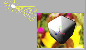

This surface is lit using a Falloff of 30 and a Spread of 27. The surface's Shine is set to 10.

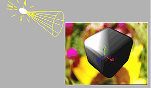

This surface is lit using a Falloff of 20 and a Spread of 27. The surface's Shine is set to 1.

In the Surface menu, make a selection in the Lighting drop-down:
Select: To reflect incidental light:
Ambient To all parts of a surface that are not directly illuminated.
Diffuse Equally in all directions, producing a flat reflection on the object.
Tip: You can optionally adjust the colour of the incidental light using the ambient or diffuse RGB channels. To display the RGB channels, click Animation to display the Animation editor. Expand the surface's folder (it should already be selected), expand its Material folder, then expand the Ambient or Diffuse folder.
