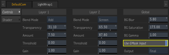

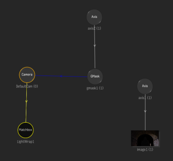

Using a GMask to Limit a Camera FX Matchbox
A GMask connected to the Camera with a GMask link can be used to limit the effect of a Camera FX Matchbox.
In this example, a Gmask is used to limit the effect of a Lightwrap effect that works well for the roof, but is too strong for the character. The Gmask limits the effect and the gradient gradually softens out the Lightwrap, so the top of the head of the character still has a little bit of Lightwrap.
To be able to use a GMask in this manner, you need to use a compatible Matchbox shader and enable Use GMask Input in the menu. GMask output passes have an option to show only GMasks connected to the current camera, so you can set GMask to not interact with the scene, and only be created to be used with the post-processing pipeline.
Without Lightwrap Without GMask With GMask and Lightwrap

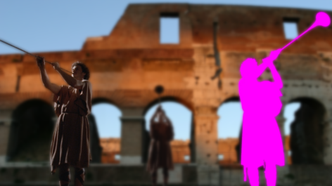

Some Matchbox shaders include 3D Selective functionality, allowing you to segment the render of Action using different 3D techniques, applying the given effects to a specific portion of the image.

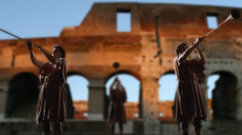

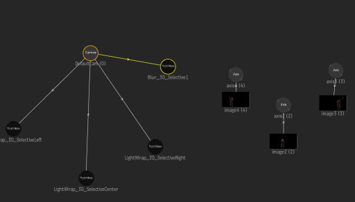

The following example shows the usage of 3D Selective with both the Lightwrap and Blur 3DSelective shader. The Blur is used to create a DepthOfField effect using the Distance mode, while three different Lightwrap3DSelective shaders are used to create independent Lightwrap effects on each of the trumpeters, as single values for all three didn't work out in this case.
3D Selective on one trumpeter Result

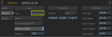

For each Lightwrap, the Cube World Selective type was used to isolate each trumpeter.

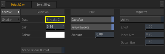

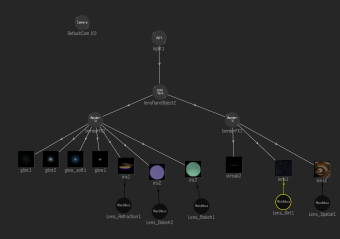

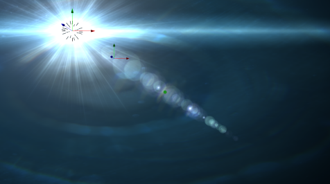

You can use the Matchbox Lens texture grid shaders with Action Lens Flares. You can use the LensBokeh, LensRefraction, and LensOptic Matchbox to replace Glint Texture, Glow Texture, Iris Texture, Ring Texture and Streak Texture nodes to create more organic Lens Flare results; and you can use LensDirt and LensSpatial Matchbox to replace the Lens Texture to create more organic lens dirt and light leak type of effects.
Lens Flare schematic with Matchbox replacements Result
In each Matchbox Lens effect's menu, you can use the texture grid functionality to select different looks. In this example, You can select different Dust elements for the Lens Dirt effect.

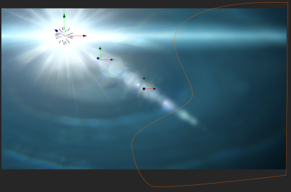

You can also use a Lens Flare Matchbox shader as part of the Camera FX pipeline. Since Lens Flares (and Rays) are rendered at the end of the Camera FX pipeline, you can instead use the ActionLensFlare Matchbox shader, which allows you to put the Lens Flare result anywhere in the Camera FX pipeline.

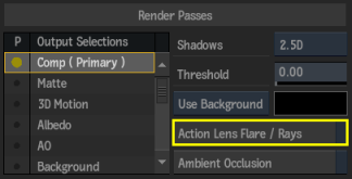

For this use case, make sure that you disable Action Lens Flare / Rays from the Comp output Render Passes menu:
In this example, there is also a Matchbox Glow effect in the Camera FX pipeline, as well as a GMask that allows you to blur part of the Lens Flare result without affecting the Action result. The Glow can affect both the Lens Flare and the Action result, since the ActionLensFlare Matchbox allows you to place it anywhere in the rendering pipeline (and in this case before the Glow effect).
Lens Flare Matchbox as Camera FX Result

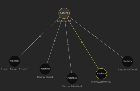

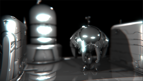

Stingray Matchbox shaders are based on the Autodesk Stingray game-engine technology, allowing you to produce visually stunning results in Action. These shaders can be combined (as in the Camera FX example below). You can also use GMasks and 3D Selectives with the Stingray shaders to help you limit the effects to certain areas of your image.
Stingray Matchbox Shaders as Camera FX Result
