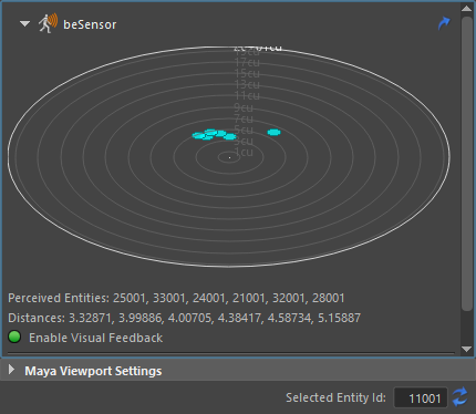

Visual Feedback
The Activate Sensor behavior Visual Feedback displays a radar view of the perceived entities or obstacles, as well as two lists, one with their ids, called Perceived Entities/Obstacles, and another one with their distances to the selected entity, called Distances.
