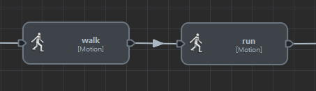

Create a simple Behavior Graph
To run two Behaviors one after another just drag-and-drop them in a Behavior Container flow.
walk and run Behaviors

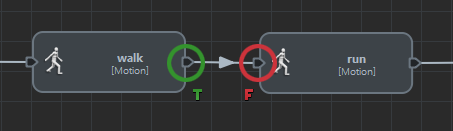

- Here the first Behavior Stop Trigger will become true during the simulation (for example when a Target has been reached). When the walk Behavior stops the run Behavior will start because its Start Trigger is true.
True Start Trigger on second Behavior
- Finally in this case, the first Behavior Stop Trigger will also become true during the simulation . When the walk Behavior stops, the flow will be stopped because the Start Trigger of the run Behavior is false. The flow remains stopped until the start Trigger turns true.
False Start Trigger on second Behavior
