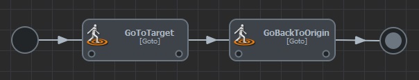

Let's consider the case of driving an Entity to a target position, then back to its origin position. This can be done using a sequence of 2 GoTo Behavior (each configured with a different target) :
A sequence of Behaviors driving an Entity to a target point, then coming back to origin

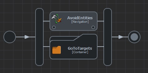

Instead of putting each GoTo behavior in a Parallel Operator with a Navigation Behavior, let's only build a Parallel Operator containing a single Navigation Behavior (that will be use by all GoTo Behaviors used by the Entity) and a Behavior Container (that will contain the GoTo Behaviors sequence described above):
A Parallel Operator running in the same time only one Navigation Behavior with a Behavior Container handling all GoTo Behaviors
