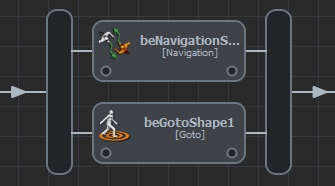

To run several Behaviors in a Parallel Operator just drag-and-drop a Behavior or Behavior Container on another Behavior, or create a Parallel Operator and add to it some Behaviors.
Parallel Operator automatic creation using Behaviors drag'n drop
A Parallel Operator containing a Navigation Behavior and a Go To Behavior

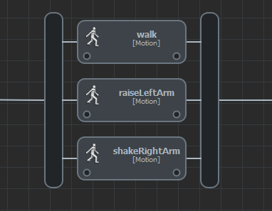

In the following example, several Motion Behaviors are used to play different animations on different body parts according to body masks.
A Parallel Operator containing three Motion Behavior
