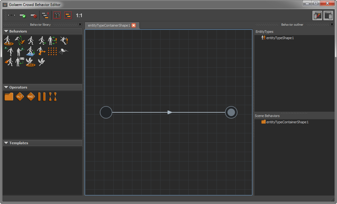

After setting up an EntityType (see Quick Start) and placing particles, open the Behavior Editor and the previously created EntityType.
Empty EntityType in the Behavior Editor

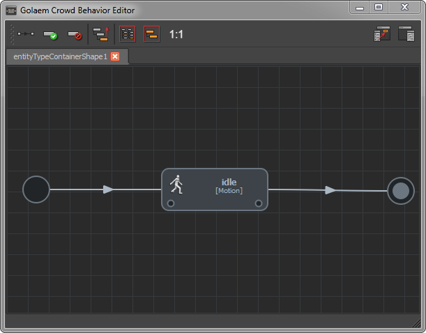

Then just drag-and-drop a built-in Behavior, as a Motion Behavior, to play an idle animation for example.
Idle beMotion on an EntityType

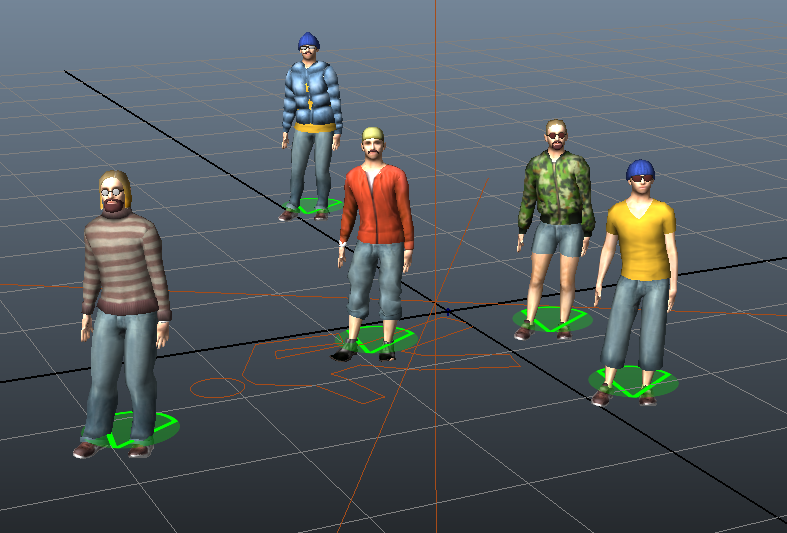

Viewport preview
