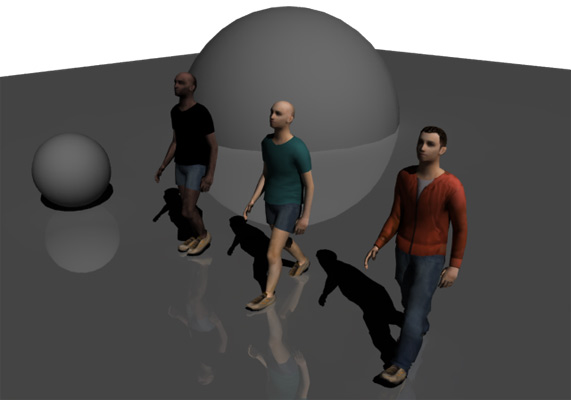

Reference Render

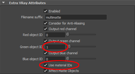

This Element creates selection masks based on Multimatte ID or Object ID. Thus, to use it with the Crowd Proxy, you need to specify a MultiMatte ID for each shader used by the Crowd Characters within Maya. If the MultiMatte ID of the skin shader is set the following way:

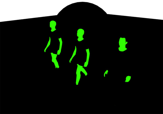

And the Multi Matte Element with the following parameters (eg meshes with shaders having a material ID of 1 will be displayed in the green channel of the Element):
It results in the following output:

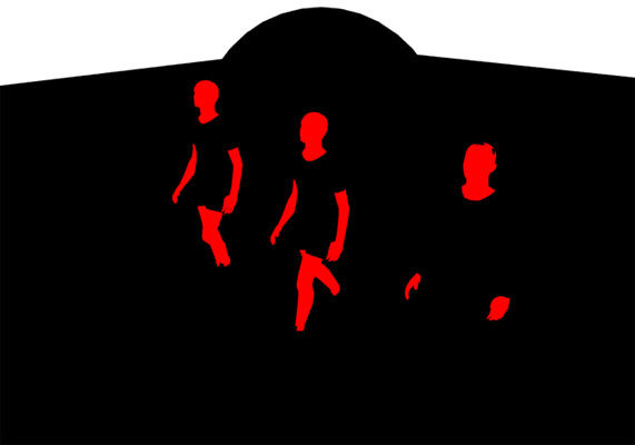

This Element outputs the Material ID color. Thus, to use it with the Crowd Proxy, you need to specify a Material ID for each shader used by the Crowd Characters within Maya. If the Material ID of the skin shader is set the following way:

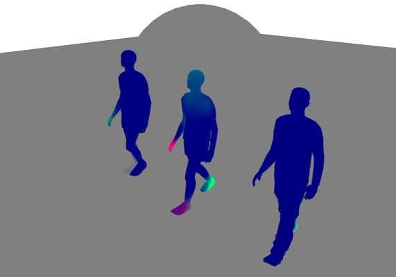

This Element outputs the surface velocity. To enable it, you need to enable the motion blur in the Render Proxy but not in the V-Ray Render Settings:
