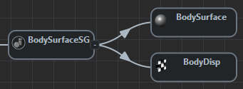

Example of a Displacement Shader applied to a Shading Group Node

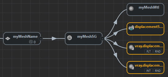

Configure a Displacement Shader by linking to the Shading Group Node some specific Renderer Attributes. Here is an example of V-Ray Attributes which can be set via the Renderer Attributes (those parameters are the same attributes defined by V-Ray for each mesh in Maya):
Attribute Name Description
vray.displacement_amount.float Determines the maximum displacement amount which occurs at places where the displacement map is white. (notice that this value can also be controlled with a ppAttribute).
vray.displacement_shift.float Adjusts the whole displacement map up and down. The effect will be to expand (for positive shift values) or shrink (for negative shift values) the displaced surface (notice that this value can also be controlled with a ppAttribute).
Example of Renderer Attributes applied to a Displacement Shader
