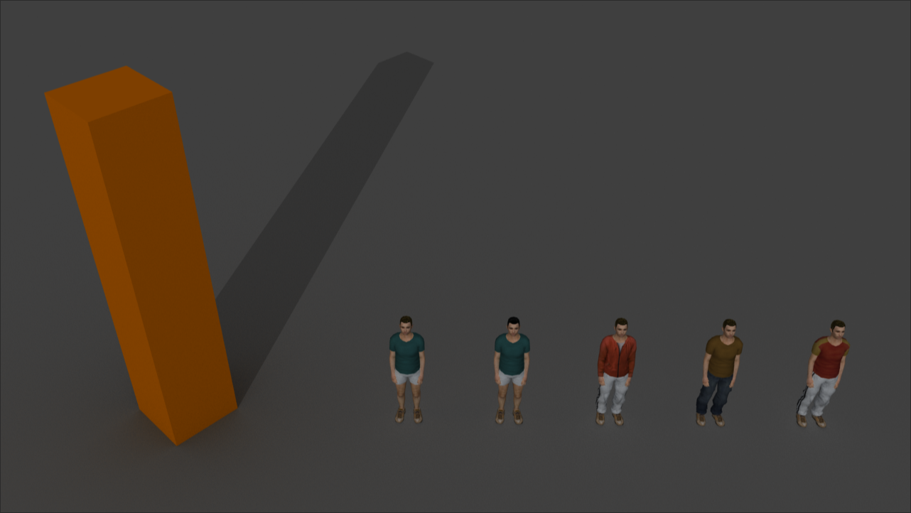

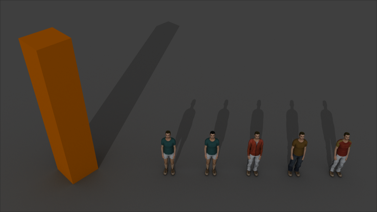

The V-Ray render stats flags for each Golaem asset are inherited from the Crowd Render Proxy attributes. You can override them on a per mesh basis in the Character Maker through Renderer Attributes .
Casts Shadows enabled / disabled
