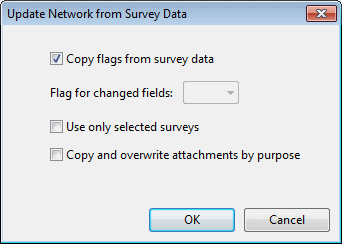

Update Network from Survey Data Dialog
The Update Network from Survey Data Dialog is displayed as part of the process of updating the network from:
The dialog allows update options to be set.
Show me
Option Description
Copy flags from survey data Check this option to import any flags stored with the survey data.
Flag for changed fields
Enabled when Copy flags from survey data is unchecked.
Select a default flag for imported data.
Use only selected surveys
Applicable whenUpdating the Network from Manhole Survey Data and Updating the Network from GPS Survey Data.
Only update from surveys currently selected on the GeoPlan.
Use only selected pipes
Applicable when Updating Pipe Condition from CCTV Data.
Only update pipes currently selected on the GeoPlan.
Copy and overwrite attachments by purpose
Check this option to copy attachments from the survey to the updated node.
The Purpose field of the survey attachment will be matched to the node's attachment Purpose field.
  • If an attachment with the same Purpose already exists at the node, it will be overwritten.
  • If there is no attachment at the node with a matching Purpose, a new attachment will be added.
Updating from Manhole Survey Data
When Updating the Network from Manhole Survey Data, the dialog also displays a Pipe Stub Options button. Click this button to display the Pipe Stub Options Dialog, which allows selection of drawing options for incoming and outgoing pipes identified in the manhole survey that do not have a specified from / to node (Collection Networks only).
Updating from CCTV Survey Data
The Update Network from Survey Data Dialog is used when Updating Pipe Condition from CCTV Data.
When updating node locations from CCTV Surveys, the Update Network from CCTV Survey Data Dialog is used. See Updating the Network from CCTV Survey Data for more information.
