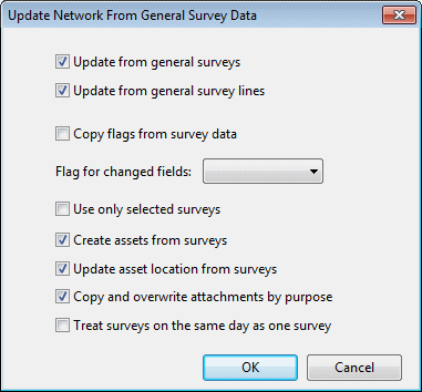

To update the network from General Survey and/or General Survey Line data:
- With the network open, select Update
from general surveys from the Network menu.
The Update Network from General Survey Data dialog is displayed.
Show me
- In the dialog, select the required options. The options available are:
- Update from general surveys and/or general survey lines
- Import any flags stored with the survey data or set a default flag for all imported data
- Update from only currently selected surveys
- Create assets that do not already exist from surveys
- Update asset X, Y location information from surveys
- Copy attachments from the survey to the updated asset
- Treat surveys with the same survey date as one survey
- Click OK to continue the update.
