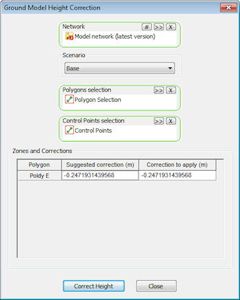

  3. Right click on the ground model to be adjusted in the Explorer Window and select Height correct from the popup menu. This will display the Ground Model Height Correction dialog.
  1. In the Ground Model Height Correction dialog select Network and Polygons defined in Step 1.
  2. Select Control Points defined in Step 2 or enter a user defined height correction value:
    • Control Points: for each defined zone the height of each control point is compared with the inferred ground model height at the XY of the control point. The height errors calculated for the control points in a zone are averaged to calculate a suggested correction, which is displayed in the Zones and Corrections table
    • User Defined Value: enter a value in the Correction to apply column of the Zones and Corrections table
  3. Click the Correct Height button to carry out adjustment to the ground model using the value displayed in the Correction to apply column of the Zones and Corrections table.
  4. Select a location to which the height corrected ground model will be saved.
