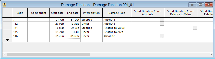

Damage Function Editor
This editor is used to view and edit a set of damage graphs defining the relationship between flood depth and damage values, where damage values are expressed as a monetary value used to calculate the cost incurred by flooding.
For each Damage Receptor you can specify:
  • The period for which a damage curve is to be created.
  • The method of interpolation for the curve, which determines if the curve is displayed as a continuous or a stepped line.
  • The damage type. The generated curve will show the relationship between flood depth and one of the following damage values:
    • total cost of damage
    • cost of damage per unit value
    • cost of damage per unit area
  • The duration, in hours, of each damage curve. Up to 4 damage curves can be generated per period.
