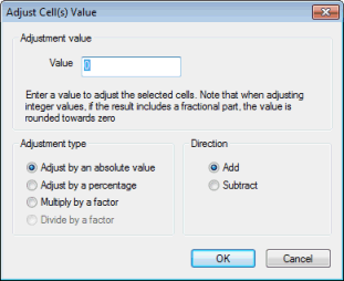

This dialog lets you to alter the numerical values of one or more fields by adding or subtracting a fixed value or percentage, or multiplying or dividing by a fixed value.
Enter the value to be used when altering the contents of the selected cells. Then select the method you want to use to adjust the cell values from the following:
Adjust by an absolute value |
The amount entered is either added to or subtracted from each of the selected cells. |
Adjust by a percentage |
Each of the selected cells is adjusted by either adding or subtracting the percentage entered. |
Multiply by a factor |
Each of the selected cells is multiplied by the factor entered. |
Divide by a factor |
Each of the selected cells is divided by the factor entered. |
If the option chosen was either Adjust by an absolute value or Adjust by a percentage, select the adjustment method:
Add |
Adds the value specified (as an absolute figure or a percentage) to each selected cell. |
Subtract |
Subtracts the value specified (as an absolute figure or a percentage) from each selected cell. |
Click OK to make the adjustments or Cancel to abandon the changes.
