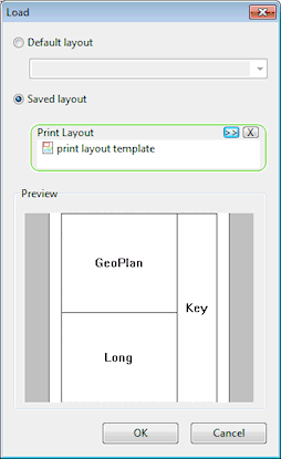

The Load Print Layout dialog is used to open a previously saved Print Layout template in the Print Layout View.
The dialog is displayed when the Load button
on the print layout view toolbar is clicked.
There are a number of built-in layouts that can be selected from the Default layout dropdown.
Alternatively, select the Saved layout option and click the >> button to display a Common Tree Selection Dialog and browse for a previously saved print layout template in the tree view.
A preview of the selected layout is displayed in the box at the bottom of the dialog.
