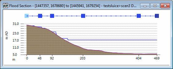

Improvement to the display of a flood section (2D)
Previously, if points in the flood section did not fall within the ground model, then the flood section may have been displayed with an undesirable ‘stepping’ effect for slopes with no water level:
Example of a Flooding Section Window (Previous Version)

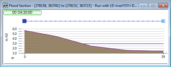

The display of the flood section has been improved to remove this 'stepping' effect:
Example of a Flood Section Window (Version 6.5)

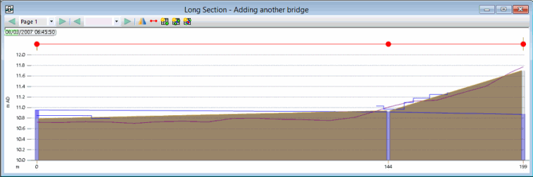

Improvement to the display of a long section
In previous versions of InfoWorks ICM, an undesirable ‘stepping’ effect was displayed in the Long Section Window if the selected run included any slopes with no water level:
Example of a Long Section Window (Previous Version )

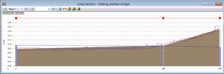

The display of the long section has been improved to remove this 'stepping' effect:
Example of a Long Section Window (Version 6.5)
