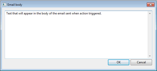

Email body dialog
Email body Dialog
Specify the text that will be displayed in the body of the email that will be sent, and click OK to save the changes and close the dialog.

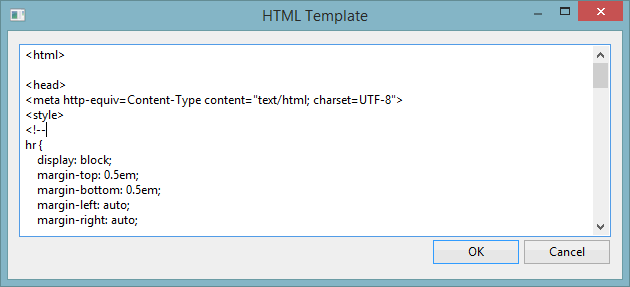

HTML template dialog
HTML template Dialog
Edit the default HTML and specific InfoWorks ICM elements (described in Action Lists), if required, for the email that will be sent when an action is triggered. Click OK to save the changes and close the dialog.

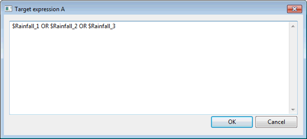

Target expression A dialog
Target expression A
Type in the desired expression and click OK to save the changes and close the dialog.
A valid expression can contain the following characters: “AND”, “OR”, “(“, “)”, “NOT” and the $ sign should prefix any alert definition ID, e.g.
Alert1 AND $Alert2
$Rainfall1 OR $Rainfall2 OR $Rainfall3

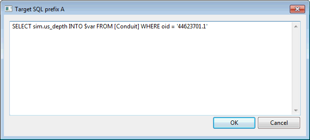

Target SQL prefix A Dialog
Type in the desired SQL query and click OK to save the changes and close the dialog.
Example
Below is an example illustrating how results/attributes from one object type can be compared against the results/attributes of any other. The FROM clause is only required where the SQL query in the prefix refers to a different object type from that referred to in the main SQL body. See Note below.
Let us consider an alert definition based on all nodes (Target type A set to Node and Target A set to <ALL>) with the following SQL query in the Target SQL prefix A dialog:
SELECT sim.us_depth INTO $var FROM [Conduit] WHERE oid = '44623701.1'
This takes the us_depth simulation result from the 44623701.1 conduit and inserts it into the $var SQL variable for use in the main SQL body (see below).

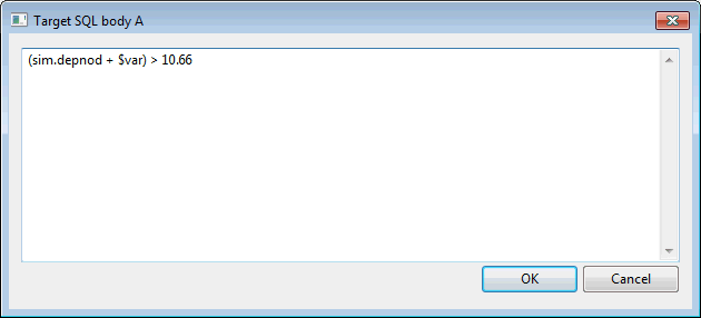

Target SQL body A dialog
Target SQL body A Dialog
Example
If we take the example started above and type in the following SQL in the Target SQL body A dialog:
(sim.depnod + $var) > 10.66
This means that an alert will be raised whenever the sum of any node depnod simulation result and the value of $var is greater than 10.66.
