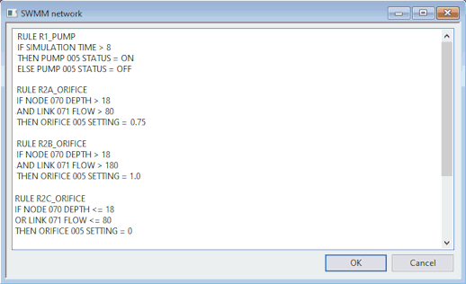

Control rules can be used to control ancillary regulator structures, such as pumps and weirs in a SWMM network, and are specified in the Control Rules Editor.
Examples of control rules displayed in the editor are shown below.
In the RULE 1 example, a simple time-based rule is used to control the timing of a pump so that it starts operating at 8 hours from the start of the simulation, while a multiple-condition rule (RULE 2A_ORIFICE, RULE 2B_ORIFICE and RULE 2C_ORIFICE) is used to control the opening and closing of a gated orifice based on the water depth at the indicated node and the flow at the applicable link.
