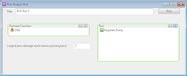

The Risk Analysis Run View schedules a risk analysis simulation. The view is displayed when a new risk analysis run is created (by right-clicking on a model group and selecting New
InfoWorks
Risk analysis run) or when an existing run is opened (by right-clicking on a risk analysis run and selecting Open).

| Run parameter | Description |
| Title |
The name of the run. If the entered title already exists, exclamation marks (!) will be appended to the run name until a unique name is created. |
| Run |
Displays the Schedule Job(s) dialog so you can specify the criteria for running the simulations. The simulations are run according to the specified schedule. The Run button is disabled if there is missing information in the view. Note: Risk analysis simulations, for
cloud databases, are only run on-premise on your computer. They are not run in the cloud.
| Damage Function |
The Damage Function to be used in this run. You can select it by:
| Run |
The hydraulic Run to be used in this risk analysis run. Multiple runs may be selected. To be used in a risk analysis run, all selected runs must use the same set of scenarios in the same version of the same network. The network must have at least one Damage Receptor in at least one of the scenarios. All simulations must be complete. You can select runs by:
| Largest zero-damage event return period (years) |
Largest return period event for which no damage will occur. May be any non-negative value, including zero. |
), selecting a damage function from the displayed tree and clicking OK.
