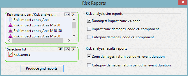

This dialog is used to generate grid reports from one or more Risk Analysis Runs, for a selection of Risk Impact Zones.
It is displayed when Risk report is selected from the Results menu.
Dialog description
Option |
Description |
Risk analysis sim/results |
The names of the risk analysis simulations or results objects from which reports are to be generated. These can be selected by:
If you select a parent risk analysis run object, all of its child risk analysis simulations and results objects will be loaded. |
Selection list |
A selection list can be used to restrict export of results to a selection of Risk Impact Zones. If a selection list is not included, the results of all impact zones will be exported. A selection list can be included bys:
Risk analysis sim reports |
Enabled when at least one risk analysis simulation object has been selected in the Risk analysis sim/results box. Used to select which reports are to be generated:
See Risk Impact Zones for further details. |
Risk analysis results reports |
Enabled when at least one risk analysis results object has been selected in the Risk analysis sim/results box. Used to select which reports are to be generated:
| Produce grid reports |
Enabled when at least one report check box is enabled and ticked. Displays a grid view of selected reports. |
button.
to include the objects currently selected on the GeoPlan View.
