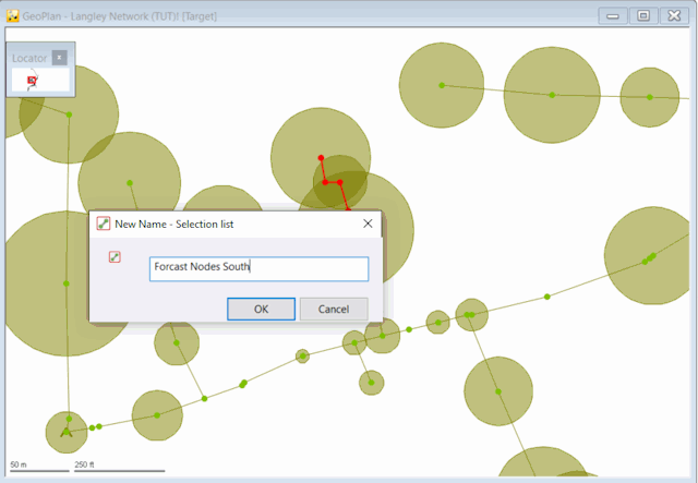

Saving selected objects as a selection list
To save a selection of network objects so you can use them again:
  1. Select one or more objects using the selection method of your choice. For example, click the button in the GeoPlan Tools toolbar, hold down CTRL and click each of the objects you want to include in the selection.
  2. Right-click a Selection List Group in the Explorer window. If there is no Selection List Group, right-click the top icon in the tree and choose New InfoWorks Model Group. Then, name it ‘Selection List Group’.
  3. Select New InfoWorksSelection List from the pop-up ]menu. A New Name window is displayed.
  4. Type an appropriate name (‘Forecast Nodes South’) for the selection.
  5. Click OK.
  6. The selection list is saved under the 'Selection List Group'.
