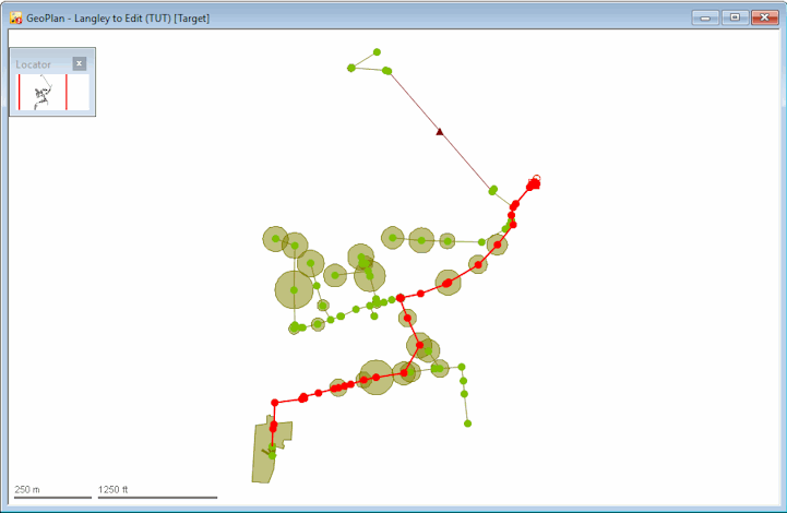

  5. Display the traced links in a long section view:
    1. Find the most western link (4462201.1). Click the button on the GeoPlan Tools toolbar to find the network object.
    2. Select from the GeoPlan Tools toolbar.
    3. Click the most south-western link (44622201.1) to trace downstream to the outfall.
    4. Save the selection in the 'Selection List Group' as 'West-East Run'. In the Explorer window, right-click the 'Selection List Group' and select New InfoWorks Selection list from the pop-up menu. Enter the name 'West-East Run'' in the New window and click OK to create the new list.

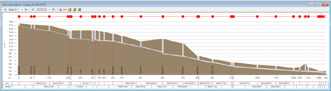

    5. Click the (New long section) in the Windows toolbar to open a new long section window.
    6. From the Window menu, select Tile Horizontally.
    7. Zoom-in on part of the long section (e.g. the outfall end) by using the mouse scroll button or clicking the button in the GeoPlan Tools toolbar and then dragging the pointer across the long section. You can also select an object in the long section, such as a node, and then use its context menu Zoom to option to zoom in on that particular object.
    8. Close the long section window and resize the GeoPlan window.
    9. Click on the Selection toolbar to clear the current selection.

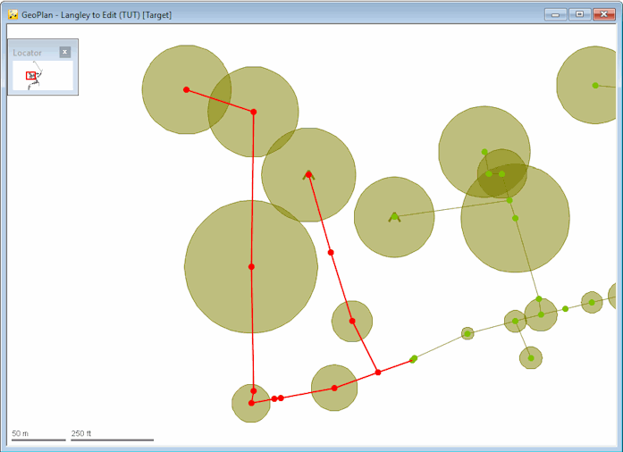

  6. To reverse the process and show where the flow comes from at any point in the network:
    1. Zoom in on part of the network.
    2. Select the button in the GeoPlan Tools toolbar.
    3. Press the Ctrl key and click a link (e.g. 44624603.1) to select all upstream links. All links that flow towards that pipe are selected on the GeoPlan.
    4. Right-click the GeoPlan and select Zoom to selection to display the whole selection.

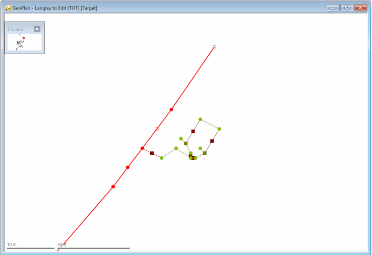

  7. Check that all links are correctly connected. This can be carried out by reverse tracing:
    1. Zoom in on the area around the outfall.
    3. Hold the Ctrl key and click a link (e.g. 44624603.1) leading to the outfall. The pipes leading to the outfall are selected.

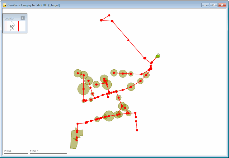

    4. Right-click the GeoPlan and select the Zoom to network option from the pop-up menu to display the whole network. Most of the network is selected but a few areas are excluded; the subcatchments are also excluded from the selection.
      The area that is not selected includes the outfall (as would be expected) and the part of the network containing the storage tanks (which is also correct). To see the storage tanks better, you may need to zoom in close to the outfall area.
