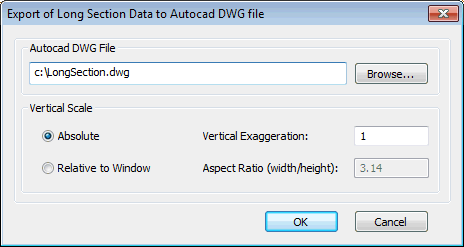

Export long section to AutoCAD DWG dialog
This dialog is displayed by the following actions:
  • Right-clicking a Long Section window and selecting Export long section data to AutoCAD DWG from the context menu.
  • Selecting Long section | Export long section data to AutoCAD DWG.
A location to which to save the files can be typed into the AutoCAD DWG File box. Alternatively the Browse button can be used to display a standard Save As dialog.
The Aspect Ratio (screen width over height) default value corresponds to that of the current Long Section window.
