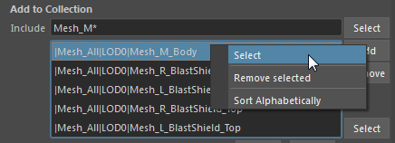

Select individual collection members
Click View All to list all your collection members. Click any node in this list to select it in the scene.
For nodes listed explicitly in the Property Editor, you can also right-click and choose Select.
