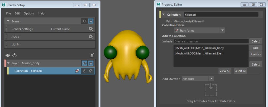

To begin this example, Mesh_Killamari_Body has a blinn7 (orange color) applied, and Mesh_Killamari_Eyes has a phong1 (green color) applied. A render layer Minion_body has been created, with a collection named Killamari.
To override the color of the squid's body and eyes
- Select the Killamari collection and middle-mouse drag and drop Mesh_Killamari_Body and Mesh_Killamari_Eyes to the Property Editor.
- Select the collection, and select
Absolute from the
Add Override drop-down list in the
Property Editor.

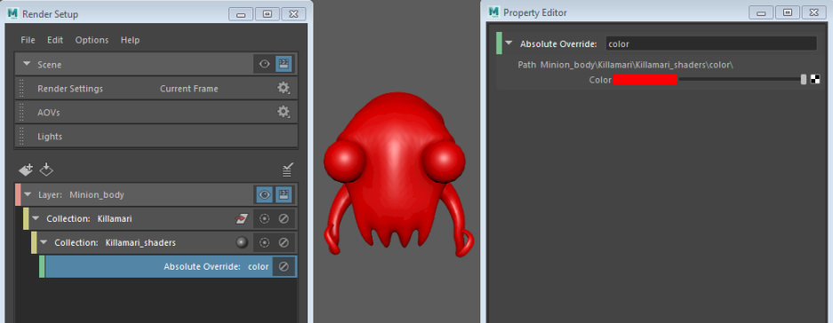

Select a shader node; for example, blinn7 to display its Attribute Editor.
Middle-mouse drag and drop the Color attribute from the shader Attribute Editor to the Property Editor.
A Killamari_shaders collection is created, as well as a corresponding color override.
Note:You can drag the Color attribute from any shader. You are only dragging the Color attribute, not the attribute of the blinn7 shader in particular.
Select the color override and set your new color values using the color swatch.
Note:The color override will be applied to all objects (and instances of objects) that are in the same layer and that have either the blinn7 and phong1 shader assigned initially.
