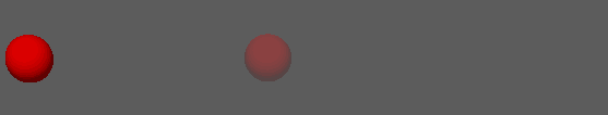

You can activate Ghosting on a clip to view the progression of a single animation clip. This lets you view the start and end positions of a selected animation clips on a track and is useful when matching poses or blocking animation.
For example, this image shows an animation clip that has been split in two of an animated sphere. The second half of the clip has been moved further along the track, creating a gap between the clips:
Note: Because Ghosting is activated for only the second clip, only the second clip has a icon next to the clip name.
In this example, clip Ghosting is activated only for the second clip, the half that shows the second part of the animation. The ghost of the second clip's start position displays while the first clip is played.
Note: This procedure shows how to show ghosts for a selected clip. If you want to see the ghost for an entire track, see the procedure for Viewing Track Ghosts in the Time Editor, above. Time Editor default ghost is a skeleton or the root object of the animation. If you would like to use something other than the default as a ghost to previsualize your animation, see Create a custom clip ghost.
To view the ghost for the selected clip
  1. Right-click the clip in the Time Editor.
  2. Select Ghost > Enable in the Time Editor clip contextual menu.. You can also select Clip > Ghost from the Time Editor menu bar.
  3. A Ghost icon appears on the clip, next to the clip's name.
    The ghost is the same color as the corresponding clip. To customize the clip ghost colors, choose a new color in the Layer area of the clip information in the Attribute Editor.
