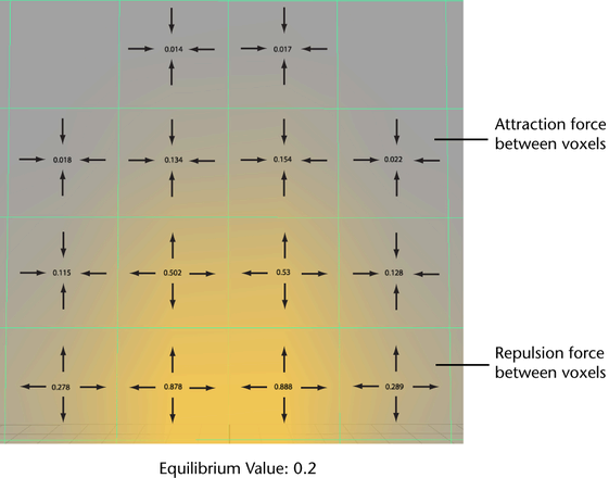

Using Self Attraction and Repulsion attributes, you can generate attractive and repulsive forces between voxels in 2D or 3D fluid containers. A Self Force attribute sets whether the force is determined by the container's Density or Temperature grid. See Self Force.
The Equilibrium Value attribute determines whether voxels generate an attractive force or repulsive force based on the grid's raw density or temperature value.
For example, if you set Self Force to Density, and the Equilibrium Value to 0.2, voxels that have a current density of less than 0.2 pull density from surrounding voxels, while voxels with a current density greater than 0.2 push density into surrounding voxels. Voxels with a current density of 0.2 are in a state of equilibrium and do not generate a force. See Equilibrium Value.
This means that as emitted density passes through a voxel and then dissipates, its Self Force changes from attraction to repulsion or from repulsion to attraction, depending on the changes in density. Scaling values, such as Density Scale, do not affect the voxel's self force. The Self Attract and Self Repel attributes set the strength of the self force. See Self Attract and Self Repel.
