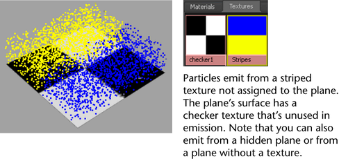

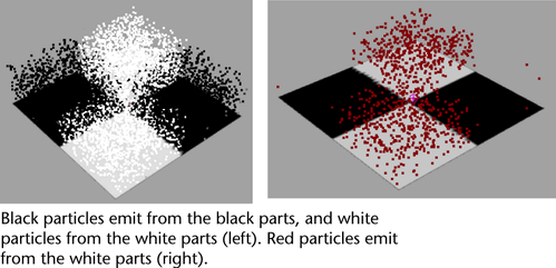

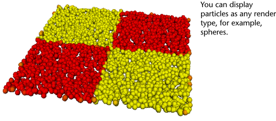

For example, suppose you add two surface emitters to a plane and connect a single nParticle object to the emitters. The plane can emit particles colored by a black and white checker texture at the same time as particles colored by a purple to yellow ramp texture. The particles are a single emitted particle object. You can display the emitted particles as any render type, for example, spheres, by setting the appropriate attribute in the Attribute Editor for the emitted nParticle object.

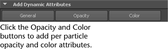

- Select the emitted particles and add a per particle color attribute (rgbPP) and a per particle opacity attribute (opacityPP) from the
Add Dynamic Attributes section of the
Attribute Editor.

- In the Outliner, select the emitter; it’s indented under the emitting surface object.
- Display the Texture Emission Attributes section of the Attribute Editor.
- Middle-drag the texture’s icon from the Hypershade onto the Particle Color attribute in the Attribute Editor.
- Turn on
Inherit Color.
When you rewind and play the scene, the particles emit from the texture with the same color and position as the texture. Note that you must turn on Shading > Smooth Shade All to see particle colors in your scene.
