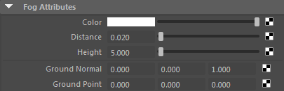

Fog
This atmospheric shader node simulates the effect of light scattering, which causes more distant objects to appear lower in contrast, especially in outdoor environments.
The aiFog node can be found in the atmosphere menu under environment in the Render Settings window.

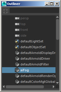

The aiFog node can also be selected from the outliner ( Show Dag Objects Only must be disabled).
AiFog accessible through the Outliner

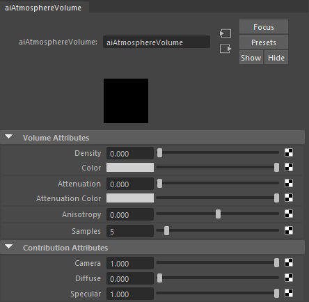

Atmosphere Volume
This shader simulates light scattered by a thin, uniform atmosphere. It produces shafts of light and volumetric shadows cast from geometric objects.
An example scene can be downloaded here.

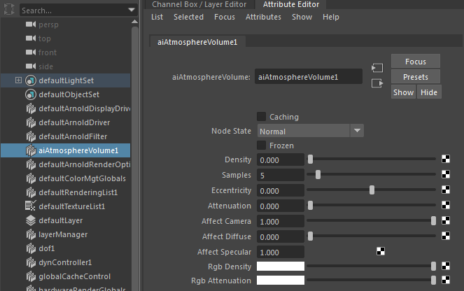

Atmosphere_volume can be found in the Atmosphere menu under Environment in the render settings window.
Atmosphere_volume can also be selected by showing Dag Objects Only in the Outliner window:
