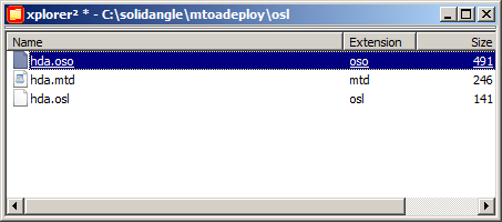

To render OSL shaders directly with Arnold, you must do the following:
  • Put the OSL shader (.osl and .mtd) in a folder, and set ARNOLD_PLUGIN_PATH to point to this folder. For example:
ARNOLD_PLUGIN_PATH=C:\shaders\osl
  • Arnold will automatically compile the .osl file and produce a dll (.oso) file.

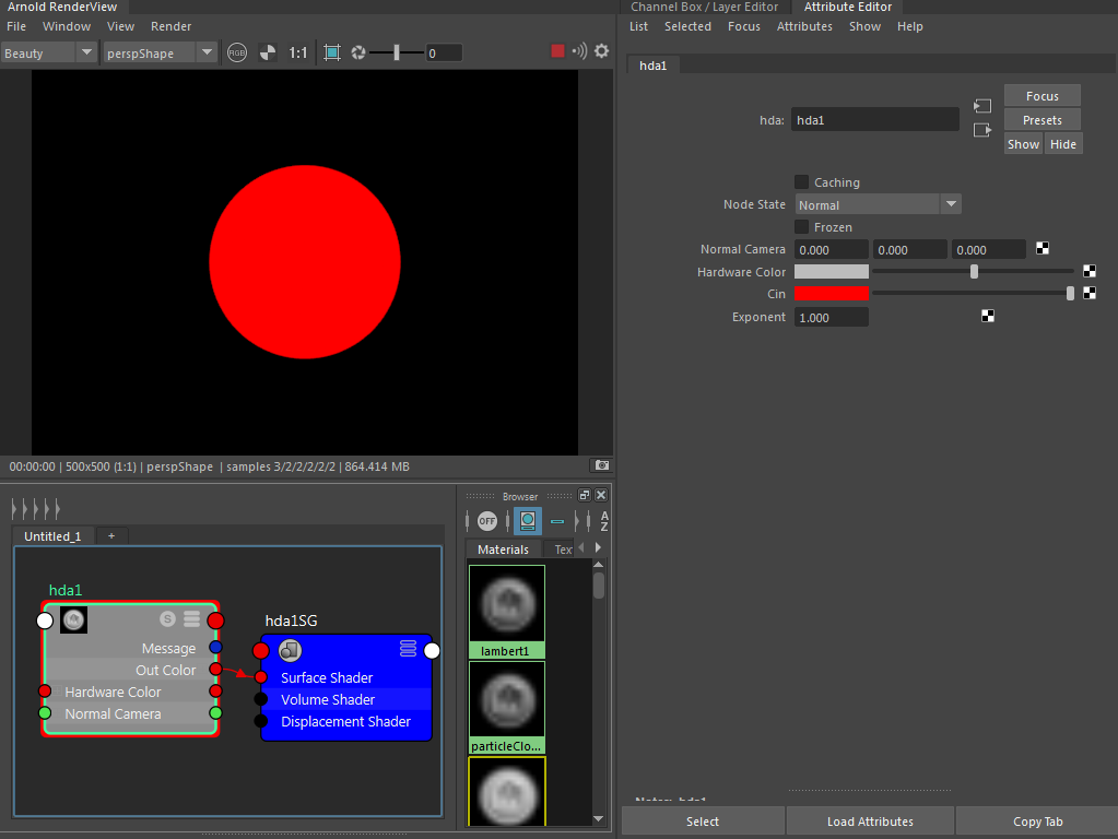

  • The shader should be visible in the Hypershade window.
.osl shader rendered with MtoA
