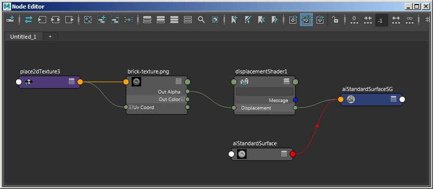

Left: Brick texture -> Displacement -> Shading Group of standard_surface shader. Right: aiImage -> Displacement (Out Color R).

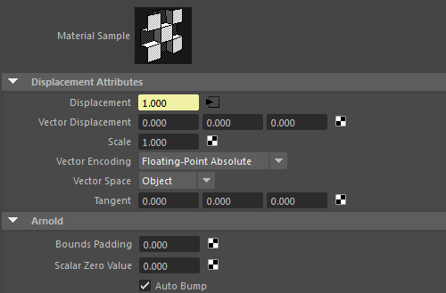

The Displacement node must be connected to the displacement attribute of the shading group of the material that is assigned to the mesh that requires displacement.

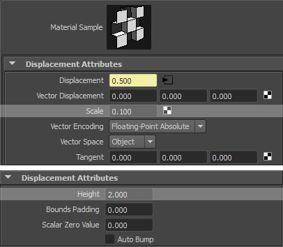

Per-Object MtoA Displacement Attributes
As well as the displacement shader, MtoA also has displacement options on a per-object basis. This means that any changes to the displacement that are made on a mesh will modify the default displacement shader attributes. This may be useful in a scene that has two objects with the same shader but requires different shape displacement values. Another example would be an object that has more than one shader but requires two different height values such as in the example below:
Same displacement shader assigned to two meshes, however, the mesh on the right has a per-object Height of 2
You will have to refresh the IPR when adjusting per-object attributes (this is not necessary when adjusting the Displacement Shader attributes).

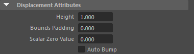

The per-object MtoA displacement attributes are divided into the following groups:

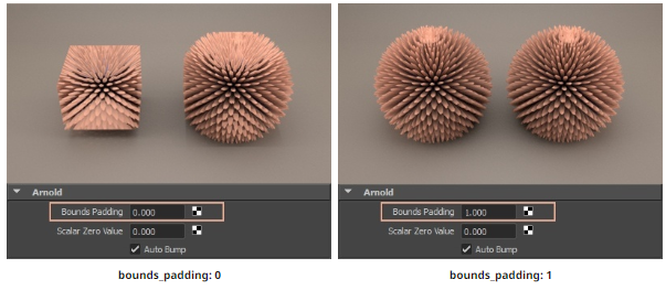

Height/Bounds Padding
The mesh on the left has a bounds padding value of 0.5 and the mesh on the right has a bounds padding value of 1 (per object settings).
Shader Displacement and Per-Object Displacement
Care should be taken when using both of these attributes at the same time. The relationship between the displacement shader and the per-object mesh displacement varies when rendering. These differences are as follows:

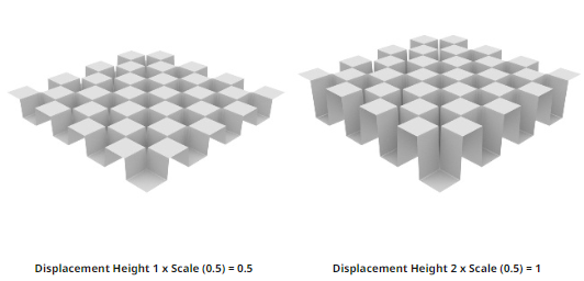

Height
If the per-object Height value is increased when there is already some Displacement Scale it will have a multiplying effect on the displacement. For example, if the Displacement Scale is set to 0.1 in the shader and the per-object Height is increased from 1 to 2, the Displacement Scale will double in size to 0.2:
The effect of the Displacement Scale doubles from 0.1 to 0.2 when the mesh Displacement Height is set to 2.
Bounds Padding
The attribute value that is the highest is the one that will be used when rendering.

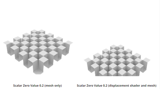

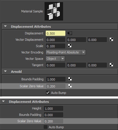

Scalar Zero Value
If the per-object Scalar Zero Value is increased when there is already some Displacement Scale it will have an additive effect on the displacement. For example, if the Scalar Zero Value is set to 0.2 in the shader and the per-object Scalar Zero Value is set to 0.2, the Scalar Zero Value will double in size to 0.4:
Auto Bump
If autobump in the displacement shader is enabled it will always be enabled. If autobump in the displacement shader is disabled, MtoA will read the shape autobump attribute and export that.
