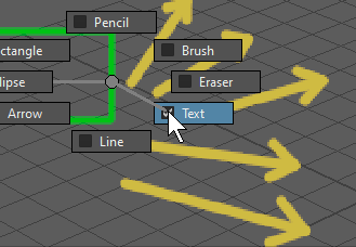

Press Ctrl + Shift and Right-click while in the Blue Pencil tool to expose the Marking menu.
The
Blue Pencil Marking menu lets you quickly switch between
Blue Pencil tools. Marking menus work well with tablet styluses or are useful any time you want to work quickly and intuitively.
To trigger the Blue Pencil Marking menu
- Open Blue Pencil.
- Press Shift + Ctrl + right-click. The Blue Pencil Marking menu appears and continues to appear while the right mouse button is held.
- Hold the right mouse button down, and drag in the direction of the tool you want; submenus appear as you drag.
- Select the tool name to activate the associated tool.
Click the tool name in the Marking menu to select the tool
- Select the tool or function you want.
Blue Pencil Marking menu options
The following are the tools available with the Blue Pencil Marking menu.
