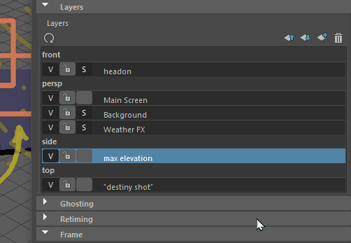

The Blue Pencil Layer manager is where you create, delete, hide, rearrange, and move layers between cameras.
Whenever you draw in the Viewport with Blue Pencil, a frame is created on the current camera view (see Camera Setup for an explanation of how Maya cameras work). But with Blue Pencil you can have multiple layers per camera, which lets you separate different images and stack them.
Layers
The highlighted layer is the "active" layer, where you can draw. The highlighted layer's Frames display on the Time Slider.
Layers are organized by which camera they are assigned to. The order the layers appear sets what order they are drawn in the Viewport, for example a layer at the top of the Layer manager is the top layer in the Viewport.

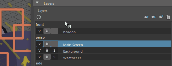

If you right-click the header for a specific Camera, for example, Front or Persp, you can move all the layers assigned to that camera to another camera.
- Deleting Layers
The Layers label
- You can also click the Layers label at the top of the table and select from the following options:
Option Behavior Delete Active Layer Removes the highlighted layer and its contents from the Layer manager Delete Active Camera Layer Removes all layers assigned to a camera, for example, 'Persp'. Delete All Removes all content from the Layer manager. - Camera Layer properties
Delete all layers assigned to a camera
The Camera label
Right-click the camera name in the Blue Pencil Layer Manager and select Delete Layers from <x> Camera.
