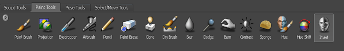

  1. In the PaintLayers window, select the paint layer where you want to invert color.
  2. In the Paint Tools tray, select the Invert tool.
  3. Stroke across the painted texture in areas where you want to invert the color.
    Paint within the brush ring changes to the inverse color hue and color value. No buildup of the invert effect occurs, as stroking repeatedly on the same region simply re-inverts the paint.
