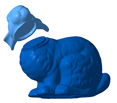

Tongue and groove
Tongue and groove, normally a feature along boards and panels of straight shape, generates a single matching plug-and-socket arrangement of surface features that follows contours of the cut of arbitrary shape.
| Wall thickness (wt) |
Thickness of the rim |
| Gap (g) |
Peripheral clearance between the two parts, seen along the parallel to the cut |
| Height (h) |
Width of the nose |
| Distance (d) |
Axial clearance between the parts, seen along the perpendicular to the cut |
Tongue-and-groove features to reassemble sections after a cut
